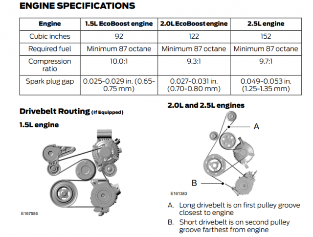

I'd also have someone inspect the radiator, serpentine belt and the coolant tank, make sure nothing is wrong.
When it "sputters" like that usually from a failure, as in a major failure. Could be wiring or something going thru the radiator and AC - .If not that, you replaced a temperature sensor. Not sure why you had to do that - but in doing so, might have upset the wiring, you may have forgotten to put something back on and it upset the system to throw that code - there may be more - later on. (I'm referring to codes it can show.)
The main premise here, is by your description of symptoms nd what you've had to do. This may also indicate a problem with powering a system - like the water pump - to keep the engine coolant flowing.
IF the pump is bad, you know what you need to do. If the belt came off - make sure all the pulleys are using it and the belt is threaded thru to make them turn - correctly.
