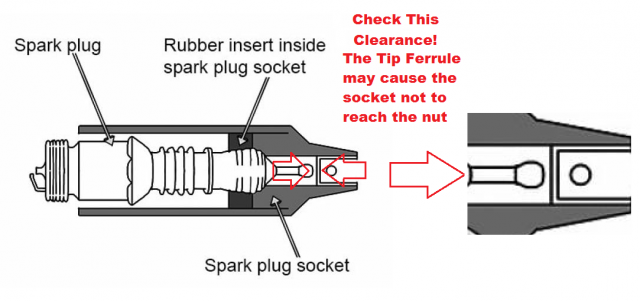

These may need to use the "socket" part of the spark plug socket to help with reach.
Meaning that the plug may be too long for the socket to fully reach the nut on the shell of the plug - because the socket may be a spark plug type, but if the terminal is interfereing with the "square" of the 3/8's socket
The problem may not be with the width, more the depth - meaning that when you use a 3/8 - ratchet, the "3/8" used to hold the socket is the problem - the clearance of the terminal - because of the length (Height) of the plug is a potential problem.
The grommet used to hold the plug in the socket, can also add a fitting problem - the grommet can't fit the insulator - the hole for it may be too small for the insulator so it's too tight to fit. So, you can't seem to push into the hole to hold the insulator, so it doesn't break and let the tool seat the socket onto the nut of the shell.

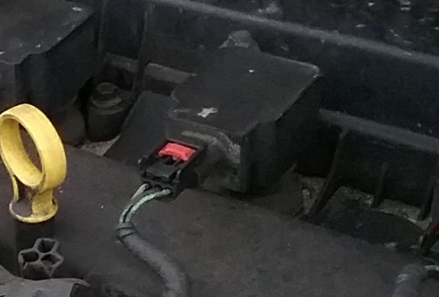

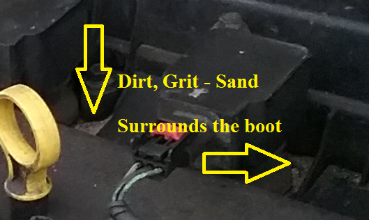

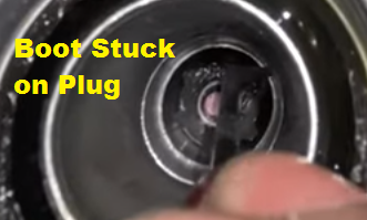

There's some grey area of conditions of you can encounter with plugs and issues around both the boot, the "coil on the plug" and these in seat types of designs - where dirt, debris and age can erode the boot to make it difficult to remove the plug because there is so much dirt and debris in the hole to keep the socket lifted away from the shell so it can't even reach the nut let alone fit the hole.
From a Ford Focus...
So, if you get the whole boot out, what is still in the hole - is there dirt or debris?
So, we need to know what kind of conditions or what you're experiencing?

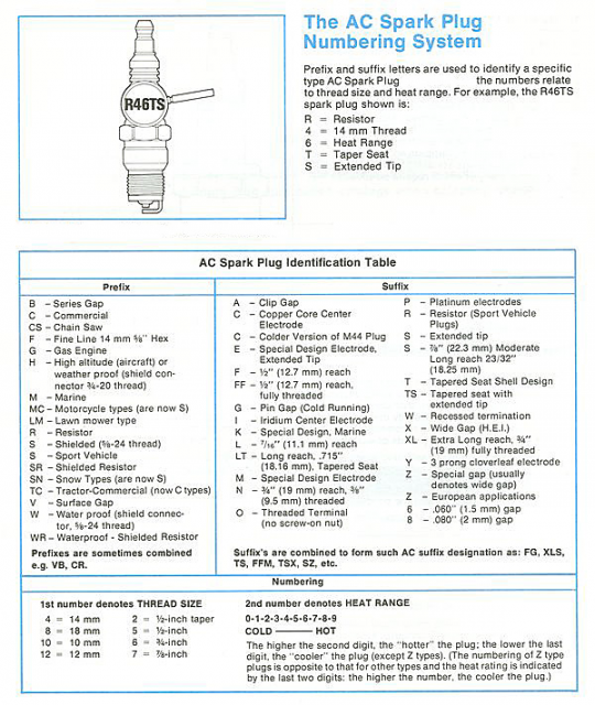

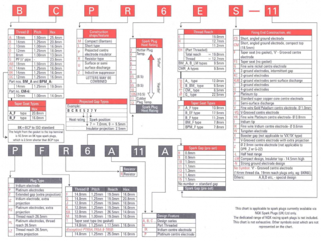

Heres why...
I did up another article I did to help someone else out - but while doing that research, I came across this...
To spoil it, remember SAE versus Metric.
Why I said the above of Toyota and Suzuki - amongst others like KIA (Aspire), SUNBEAM (Tiger), Sprint (Metro/GEO) - any one type or brand of car that got introduced to the USA thru one of our Big Brands like GM, FORD and Chrysler - these "work alongside" details of having to stock parts of different size and metrics - the hardware and all the nuances to go along with it - ADDED to this problem of knowing which socket to use and the go to for the various types of engines and spark plugs used in them.

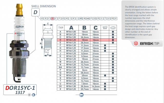

The reason why this comes up is how some interpret charts for the various plugs and their cross-reference equivalents
Here...

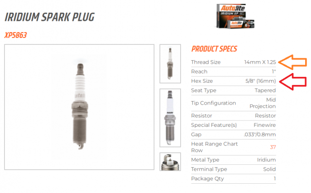

AMBER Arrow - points to the THREAD size
RED Arrow - Points to the HEX Nut size
So, to help the next one - SOME of the SAE and Metric size are considered to be nearly the same in fitment for the size of the mm to fractional inch are close for most tolerances for the tool and bits, that - both could be used and considered safe for torquing and not rounding off the shoulders of the nut.

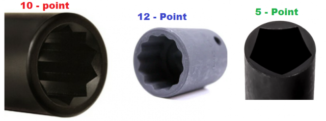

Although another issue that sidelines this, deals with what some show as an ingenious idea to show the insanity of different hardware used in older vehicles versus todays, deals with why there are
10- sided versus 12-sided even penta-sided - points in sockets and how some nuts are - just plain crazy...
